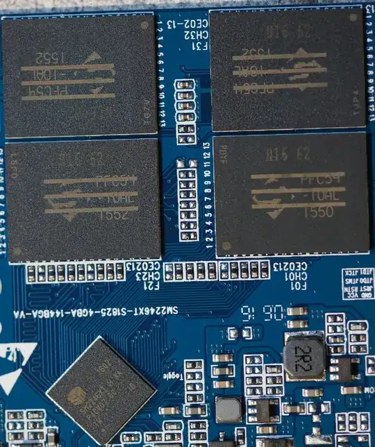

I recently purchased a really, really cheap SSD ($25.99), and I popped open the case out of curiosity.
The flash chips have etched bars across the part numbers, something I've never seen before.
Is this a standard way of marking chips as rejects?
Edit: I bought two of them to put in RAID-1, because I don't trust them too much, and the other one has identical markings:
This one uses Micron flash, though the marking is identical.
At this point, I can only think it must be a really, really, really ineffective attempt to hide the flash part numbers?
The micron parts are MT29F128G08CBECBH6-12:C, which is a 16GByte part, so there is 64 GB of raw storage.
The other parts are "Spectek" branded, which is apparently a micron subsidiary I'd never heard of before. They appear to be FBNL95B71KDBABH6-10AL, which are also 16 GByte parts.

Back to Amazon they go, I guess. I think I'll see if I can convince the other to fail as well, before I return them.
Edit edit edit edit:
Yep, second drive just crapped itself when tested in the exact same manner. Whoops?

    That's really interesting -- wouldn't they be able to test the die pre-packaging as not to waste money packaging a die that's broken? I guess if they don't have that setup, perhaps it's marked after packaging + test to mark non-conformance and then escapes into the "grey" market -- curious to see what the answer is. – Krunal Desai Mar 15 '16 at 02:17
  • It's possible that there was an issue during the silk screening process - in that case they would probably be rejected even if the die was perfectly fine. Out of curiosity have you tested the SSD, any bad sectors? – Tom Carpenter Mar 15 '16 at 02:29
    @TomCarpenter Looks more like laser markings than silk screened markings. Reminds me of the fake Chinese USB drives that report large available capacity until you try to actually store and recall more than 2G or whatever- the controller chip has been fiddled. – Spehro Pefhany Mar 15 '16 at 02:51
  • @TomCarpenter - It's definitely laser markings, not silkscreen (does anyone silkscreen chips these days?). I haven't thoroughly tested them, though I was able to install linux fine. They're 60GB drives, and I just planned on using them as boot drives for a server. Better then a thumbdrive. – Connor Wolf Mar 15 '16 at 03:00
    Maybe they do that to discourage harvesting the chips to sell by themselves. – tokamak Mar 15 '16 at 03:41
  • @SpehroPefhany my bad, half asleep. – Tom Carpenter Mar 15 '16 at 03:49
  • The fradulent/faked capacity thing is interesting. I'm doing a long smart test now, and I'll probably try to write every byte after that. – Connor Wolf Mar 15 '16 at 04:04
    Given both types of flash are the same manufacturer (or subsidiary of it), then they were likely produced at the same fab plant (and packaged in the same place). So it is entirely possible that they could still be rejects with the same markings even if they are different ICs. In fact the presence of two completely different flash ICs in the same product does seem to suggest a "we'll use whatever we can get our hands on" attitude which certainly doesn't rule out the use of rejects. – Tom Carpenter Mar 15 '16 at 04:23
  • First I thought that there was a problem with the laser, some "bits" were stuck, causing the print to fail for otherwise good chips. Scrapping them would be wasteful so maybe they sold them cheaper to a known customer. After a closer look, this should not be the case since the stripes are actually at a different offset on every chip, meaning that they must have been added later. – pipe Mar 15 '16 at 04:37
  • @pipe - You can actually make out that the bar markings were added later in some cases - the area where the markings overlap is etched a little bit deeper. – Connor Wolf Mar 15 '16 at 16:37
  • If they are fakes, a SMART long test might succeed anyway. You should instead do something like write zeroes to the entire drive. – longneck Mar 17 '16 at 14:15
  • Is there any Rev history on the PCB? that could explain the two different sources, though the bars remain a mystery. – MadHatter Mar 20 '16 at 23:15
  • @MadHatter - The Spectek part is billed as being pin-compatible with the Micron part. No board revision required. – Connor Wolf Mar 21 '16 at 02:23
  • @TomCarpenter - Well, running some thorough tests seems to have at least partially broken the drive. Whoops? – Connor Wolf Mar 21 '16 at 02:24
21
I emailed Ted Netz, the NAND flash product manager at SpecTek. Here's what he had to say (with a few minor grammar and formatting fixes):
Hi Adam,
We do mark products this way. It is a type of part we sell that may have a mechanical defect, but often tested electrically good. We sell it as risk product, as is, at a discount and do a 3 bar deface on it so it cannot be returned as an all good device for RMA. The mechanical defect typically will not let it pass our automated scan steps. Typically it fails for coplanarity or could have a missing or smashed ball. Folks are willing to rework the part and are supposed to retest it. However we usually advise customers to restrict these devices to USB apps or lower tier apps only as they may not meet all performance standards. As well, we cannot control the customer rework process so again we will not warranty such a device.
However there is another odd thing on these. The extra characters H16 62 are not part of our marking scheme. We have had folks counterfeit both the Micron mark and/or the SpecTek mark in this fashion to pass off the parts as SpecTek original. The odd thing to me as well is the scribe adjacent to the pin one mark. On the SpecTek marked drive the font is different on 3 of the marks which do not look like typical Micron scribe fonts. Anyhow hope this helps.
Thx -- Ted
So the three bars are a legitimate marking for high-risk no-warranty discount flash with mechanical defects. Customers are supposed to rework and test the chips on their own. However, based on the extra markings it seems like the chips in your drive might be counterfeit. Maybe it's easier to get away with counterfeiting a lower-quality product.

    The extra marks may have been added by the third party that reworked and tested the parts. As in, they are their QA codes. They look like they were applied via a different mechanism. – John Meacham Mar 22 '16 at 21:42
  • @JohnMeacham Based on the failure of both drives, I'm skeptical that any testing was done. But I agree that a third party probably added the extra characters. – Adam Haun Mar 22 '16 at 22:05
    @AdamHaun - Considering that they appear to have failed in the same manner, I think buggy firmware is more likely then bad flash, but that's just a guess. – Connor Wolf Mar 23 '16 at 21:16
  • @ConnorWolf Maybe. But firmware is easy to copy, and the controller has a Silicon Motion part number. They seem to be a legitimate company. I'd be surprised if their firmware were *that* buggy. Third-party counterfeit firmware, on the other hand... – Adam Haun Mar 23 '16 at 21:37
  • @ConnorWolf I wouldn't expect random USB disconnection from firmware, either. There could be a gross electrical problem causing a brownout. It might be interesting to scope the supply voltages while you run badblocks. – Adam Haun Mar 23 '16 at 21:38
    Well, they went back to amazon on monday, so it's a bit late for that. They're $26 on amazon if you want to experiment yourself: http://www.amazon.com/gp/product/B00W2XMUSS – Connor Wolf Mar 23 '16 at 22:06
  • Wow, those are from Amazon? I figured eBay for sure. I think I'll pass on buying my own. :-) – Adam Haun Mar 23 '16 at 22:33
