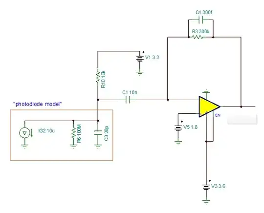

  • 3-5 mV exists even without the 10K and the C1. Essentially no input to the opamp. This makes me think that my layout is not perfect.
Here is the basic schematics for the amplifier. I can add more if we think it is necessary.
Schematics

It sounds like your primary concern is noise getting onto your analog signal. You currently have 3-5 mV noise on the output of the first amplifier, but you want to get that down to 1 mV. You say this is a transimpedance amplifier, but this is contradicted by your gain of 300k, so we still don't know what your circuit really is.
Where is the input signal coming from? How does it get to the amplifier input? What is its reference and what have you done to insure this reference is clean? The real issue is to make this first amplifier stage as low noise as possible. After that the signal is higher level and lower impedance, so it won't be as susceptible. What are the external noise sources that get onto the input signal? How much noise do you get out of the first stage if you short its input?

3-5 mV exists even without the 10K and the C1. Essentially no input to the op-amp. This makes me think that my layout is not perfect.
That tells you the noise is not coming from the photodetector, so you can forget about that for now. The noise is either on the bias voltage for the positive input or is on the ground.

The 3.3 V supply (also the supply for the op-amps) are filtered via a 2.2 µF tantalum capacitor and a pi network (100 kHz roll over) before the supply to the photodiode (that is, before the 10K resistor).
But you don't show any of that. A tantalum capacitor will have poorer high frequency response and higher ESR than a ceramic capacitor. There is really no reason at all to use a tantalum capacitor at this voltage and capacitance. Also, a capacitor by itself isn't much good without some impedance to work against. You mention a pi network, but none of this is shown on the schematic and you only talk about a single capacitance, so that doesn't add up.
As I also said before, 100 kHz is too high. As I said, I would like to see that 10 kHz or less.
We also have 1/100/10 nF capacitors close to the 10K.
Good, but again, they need some impedance to work against. A ferrite bead chip inductor in series with the supply feed would do that, as I said before.
Op-amp has 1/100/10 nF at supply and bias pins
OK, but once again, these need some impedance to work against. A chip inductor in series would help.
Also, again, where exactly do these capacitors connect to the ground? I suspect you are just punching through to your ground planes. Again, this should all be connected to a local ground net connected to the main ground plane at a single point.
The feedback capacitor and resistor are placed as close as possible to the op-amp.
Good.
All signal traces between the photodiodes and op-amps are minimized; we are talking <2 cm worst case
You have already shown this is not where the noise is coming from.
