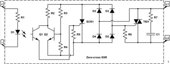

The MOC3043M is a zero-cross triac driver. Internally there is some circuitry to allow switch-on close to zero-cross and inhibit it otherwise. This circuitry needs power and so the 1k resistor between the gate and the output allows the device to "steal" some power from across the main triac without actually triggering it (when it shouldn't).
If found the internal schematic for the G3MB-202P 5V input (Zero crossing and built in snubber) some time ago and it may help your understanding.
Figure 1. Simple SSR has zero-cross on/off switching - EDN.
  • If \$V_{L1-L2}\$ is low (above but close to zero) and Q1 is turned on by photo-action from D1 then SCR1 will be triggered. This in turn will pass enough current through R6 to bring TRI1 gate voltage high enough to trigger.
  • When voltage exceeds a certain level Q2 will be biased on. The collector voltage will fall and there won't be enough to turn on SCR1.
The effect is that TRI1 can't turn on unless it is triggered close to the zero cross.
It should be fairly clear to you that this circuit requires some current to operate and that the 1k resistor in your diagram provides a path to neutral and through the load.
