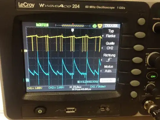

The problem: Some output voltages work fine, i.e. the voltage stays constant and the current (drawn from the source) is as expected. But other voltages produce a strange phenomenon: The switcher is on (i.e. mosfet is on almost all the time) so that the current increases over a lot of periods (the voltage at the feedback pin goes way above the reference voltage) and results in a heavy current surge which results in current limiting of my voltage source and voltage drop. The switcher turns off and the current goes back down. This repeats a few times per second.

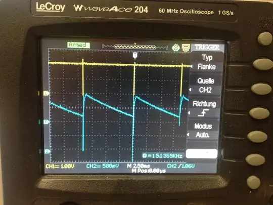

Here scope shots, when good and bad, zoomed in and out (in time):ok This is ok, voltage stable. enter image description here Signal from former pic zoomed in. Caution, yellow signal measured at the input of the mosfet, therefore it is inverted (low=Mosfet on). enter image description here Here the problem occurs. The voltage at the feedback pin rises far to high (note different volt/div) and the supply voltage drops (seen at the yellow signal). enter image description here Again a zoom of the bad signal.

  • Good point. The blue trace is the voltage at the feedback pin of the IC. Yet it is proportional to output current which must be rising given the blue trace. I will check that, although I believe to remember checking that the Mosfet was working correctly. But There must be something wrong, I will look at it asap. (Not at the lab today) – jjstcool Mar 11 '16 at 11:32
I'm amazed it works at all.
You've completely omitted the single most important component of any buck converter, of course it isn't working.
Where are your input capacitors?!
Your voltage source (presumably a lab power supply since you mention triggering it's current limiting) should not be even care about the current spikes because all the current should be coming from your beefy input capacitors which are placed as close as possible to the anode of the switching diode and source of the P-channel fet.
The yellow is the input of the mosfet? You should not be able to tell when the MOSFET is on or off by measuring the input to it, because your input capacitors will maintain the voltage. You're powering this directly from your lab power supply without any input capacitance at all, aren't you?
Buck regulators work by drawing large but brief amounts of input current. You need to understand - MOSFETs give dV/dT rise and fall times the likes of which the ancient, slow, and terrible LM2576 doesn't even know were possible. You need some solid ceramic capacitors millimeters (like, single digit numbers of them) from the MOSFET input and the diode anode. You also need some nice and chubby electrolytics near the ceramics to provide the bulk energy storage you need. The input ripple on the MOSFET should be below 80mV. More than this, and you'll probably exceed the ripple current rating of any electrolytic capacitor on the input regardless of how large - even at 52kHz, many electrolytic capacitors will be essentially resistive and will just get hot from the ripple. Reduce it to 80mV with ceramics however and they should be safe. Your ripple looks to be...well, it's definitely not below 80mV, let's leave it at that.
Also, that regulator is internally compensated so it is probably the worst choice for what you want to do. Even if correctly decoupling the input of your circuit solves the first problem, I would not be that hopeful of it working with your instrumentation amp thrown in. An entire slow-as-a-diddly instrumentation amplifier crammed into your feedback loop is going to crush what little phase margin the LM2576 had left and it will just be a glorified chaotic oscillator. And you won't be able to do anything about it because the output of the error amplifier isn't broken out to the frequency compensation pin so you cannot do anything to stabilize.
