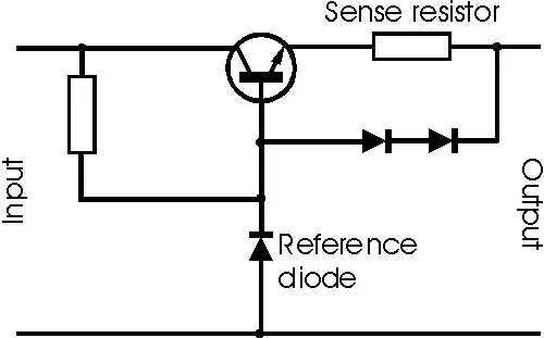

I borrowed and modified this picture. Is this a good way to do this or is R1 not needed or even a mistake?
