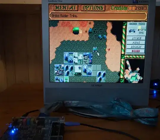

I can't figure out how to use double buffering because I can't figure out how to write data to the memory while reading. Is there a way to avoid bit-banging the protocol? How does this guy do it?
