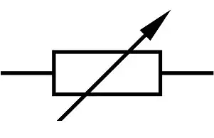

A Rhoestat is not the same thing as a Potentiometer, since a Rheostat is typically considered to be mechanically variable resistor and is a 2-terminal device.
You can use a Potentiometer as a Rheostat by simply ignoring one of its fixed-resistor terminals.
