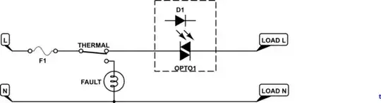

Figure 1. Triac controled load with thermal trip and fault indicator.
The triac option has no moving parts and could provide a good solution to your problem. The SSR (solid-state relay) versions include the opto-isolated trigger circuit which keeps mains away from your control circuit and many incorporate a zero-cross switch on which minimises transients and noise from the wiring.
Best practice would be to have a separate thermal trip on the boiler. Figure 1 shows one configuration with a trip indicator.
