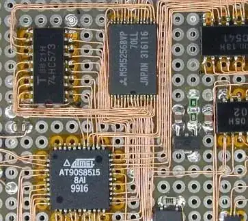

Here's another interesting method of perfboarding, this guy does it with SMD components and really tiny wires. He made a special little wiring pen for laying down the wires:
Progressive Wiring Techniques
example
(source: davr.org)
Personally I make solder bridges for pins that are in adjacent holes, for things further away I use thin wires (though not as thin as the ones above) in adjacent holes to the things I want to connect.
