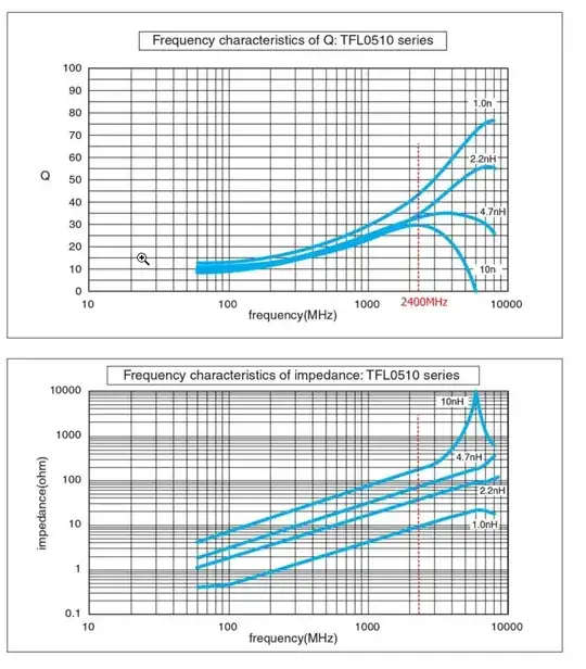

  • Just for clarification.I did some calculation with the 27nH inductor(2.8GHz-SRF)and it seems to be the best(no need addition capacitor).I understood that,as you mentioned,the effective capacitance could vary widely,but the 2.8GHz is rated as min.SRF,so the resonance can only be deviated at higher value(>2.8GHz).With 10nH and 4.7nH inductors,the min. SFR is higher than the 27nH inductor and they also can have either way,the same deviation toward the higher frequecy,While with the 10nH/4.7nH inductors,i need to add capacitor and with the 27nH inductor,i can omit it.So why not use the 27nH one? – xchcui Mar 10 '16 at 18:37
    @xchcui it says why in the answer, reproducibility. You say you want a 2.4GHz resonator. If you build three and actually get 3GHz, one time, 2.8GHz another and 3.2GHz another, and you're happy with that, then go for it. If you want 2.4GHz +/- not much each time, then you have to choose a much higher SRF, and use a real component for the capacitor. Using a large capacitor allows you to tune the inductor like Andy suggests, using the inductor's SRF means that tuning technique will not work. – Neil_UK Mar 10 '16 at 18:49
  • Neil_UK,There is a very relevant question(included graphs)that i added to my question.I don't find the answer in yours answer and it's very essential to understand that condition.You chose the 4.7nH(~3.3nH)from the practical value of 1nH-10nH by geometric mean and said to see if that gave me reasonable Q or impedance.The graph shows that 2.2nH/1nH give better Q and lower impedance.So,is it better to use them,after these new spec. or is there another reason for using,actually,the 4.7nH and not the others(which are in the practical values).Solving that will be a good way to close the subject. – xchcui Mar 13 '16 at 11:13
    @xchcui It may or may not be better to use them, because we are not interested in the Q or impedance of the component, we are interested in the Q or impedance that the whole circuit needs to produce, when connected to the other components around the tank. The *loaded Q* is always below the component Q, because it includes the resistive losses of the circuit. We have gone as far as we can considering the components alone. See the 4th paragraph in my answer 'Once you're more advanced ...'. Try out a filter design program, and see the range of inductors it picks, each one for a different Q! – Neil_UK Mar 13 '16 at 15:22
  • @xchcui I've edited my answer to put some meat on the bones of the previous comment. – Neil_UK Mar 13 '16 at 16:05
