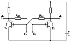

This is a bit like the latch in the below diagram except there are no resistors (the collector resistors are replaced by the PMOS devices M2 and M4)
The value to be written is placed onto the BL lines, then the WL line is set and state is forced as M5 and M6 (which would connect at A1 and A2 - or E1/E2 as RB1 and RB2 are not present) have a much higher drive than M1,2,3,4, overriding them and forcing a state, which will then be held.
2 transistor latch
You can see this does not require a clock, just a simple set/reset operation. In contrast some latching circuits (there are many) use a clock to enable the set/reset to take place (effectively gating the input signal)
