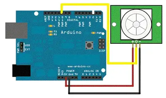

This is my first time to use PIR (HC-SR501 ) . It's in repeat trigger model. But when I test the output of the PIR , it gives always HIGH . enter image description here
I rotate sensitivity adjustment and time delay adjustment randomly to see any changes occur. I even cover the sensor with cloth so that It get's no infrared . still it gives high. I changed my sensor and bought a new one. This shows the same problem too. arduino code :

  • I give this cartoon (which is my actual connection ) cause I don't find anything for arduino in schematic editor and had to make some block representation of it and the sensor. So it seems like this fritzing cartoon will be better representation of my circuit then just a block. thnx – Anklon Mar 03 '16 at 21:56

I encountered the same problem. The solution was simple in my case. Check if your + and ground are connected correctly!! If you look at the image you would suggest that the left cable is the + (red cable). But if you look at the connection sheet HC-SR501 this is the ground connection. And so you could be tricked by having it connected as the drawing suggests.
