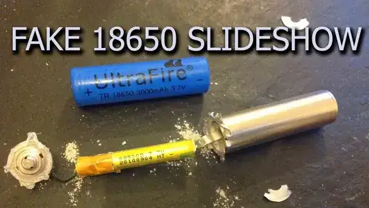

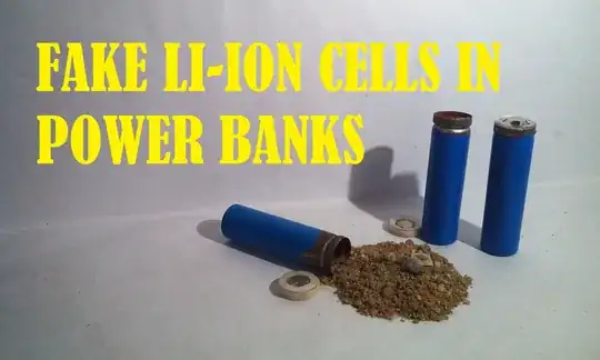

At least these are fireproof:
These... maybe not.
Source: fake 18650 teardowns.
