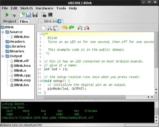

Personally I recommend (since I wrote it ;) ) UECIDE. It was originally based on MPIDE for the chipKIT boards, which itself was based on version 0023 of the Arduino IDE, but there's not much of the original code left now, it has all been re-written.
It supports all the Arduino boards, plus chipKIT boards, Launchpad, Maple, and a whole host more.
