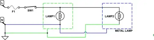

Figure 2. Swapped N and E on LAMP2.
Things get much more interesting and dangerous once we start mixing up N and E. In the example shown in Figure 2 all appears well to the user and even the electrician doing a voltage test.
simulate this circuit
Figure 3. Broken neutral - live equipment case.
Figure 3 shows one potential scenario.
  • The neutral wire has broken.
  • SW1 is on so the N wire is connected to mains through LAMP1.
  • LAMP2 is lit as it has a return path to the generator.
  • LAMP2's case is connected to the now live part of 'neutral' circuit.
  • Anyone touching LAMP2 is in danger of electrocution.
