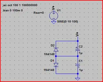

33
I am aware this has been done successfully for ages, but why it works is worth looking at.
I thought I would set up a quick simulation based on the info given by Russell in his answer. The main point being the "act as if they had been bypassed by diodes" part. It's a very rough approximation but it gives a picture of what might be happening.
Bipolar Schematic
Bipolar Simulation
The I[D1] and I[D2] represent the reverse current through the caps. Initially one of the caps gets a brief surge of reverse current, then it becomes minimal for both. The I[C1] and I[C2] represent the current through the capacitance. This meet expectations of a 0.5uF cap at 100Hz. The capacitive reactance
$$\dfrac{1}{2\pi \cdot 100 \cdot 500e^{-9}} = 3183$$
So peak current will be
$$\frac{10}{3183} = 3.14mA$$
The light blue wave in the third graph is the supply voltage. The dark blue and green waves in the third graph represent the voltage seen across each capacitor (+ terminal with respect to - terminal of each)
As can be seen, both are correctly polarised.

I saw the roll your own bipolar cap made from two back to back electros of the same value with the reverse diodes across them.This was back in 1988 ,when I was fresh out of Uni.I did not like them at the time and vowed not to do this on anything new .The broadcast audio product that used them was manufactured in hundreds and did not fail so my boss did not get me to redesign it .So the reliability was fine in this low ripple current application .What the tech and I did was test the aformentioned caps on the AUDIO PRECISION test set which was at the time the bees knees .None of us could find any distortion coming from the caps.This was not what I expected or what others that watched the tests expected.On the other hand speaker crossover networks often use bipolar eltec caps that have been known to fail and take out the tweeter.On the rare occasions that I replace someones tweeter I discard the bipolar electro and replace with metal film .

    When used in the passband, caps have minimal voltage across them and therefore minimal distortion. Both sides go up and down together. If you put low enough frequencies through it, you would see distortion. – endolith Sep 20 '15 at 18:29
  • We were using the electro as a coupling cap because we wanted the test to represent the broadcast line amp that was being manufactured.I have and will never use an electro in an audio filter.I saw someone use one in a telephone hybrid once .It wasnt good 15microfarad ,borderline return loss .If someone uses electros for subsonic cutoff they could expect distortion around the cut frequency. – Autistic Sep 21 '15 at 11:15
i did it with four 30uf caps, all negs connected. Take two pos for one side, two for the other. All four caps were 30uf at 150V. Do the math however you want, but the speakers worked well for 33 years until I had to change the components out simply because it was time to re-cap the crossovers and re-foam the woofers.
