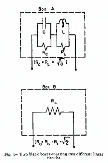

Two black boxes display the same impedance at all frequencies. The first contains a single 1 Ohm resistor. Each end is connected to a wire, so that two wires protrude from the box. The second box looks identical from the outside, but inside there are 4 components. A 1 F capacitor is in parallel with a 1 Ohm resistor, and a 1 H inductor is in parallel with the other 1 Ohm resistor. The RC combo is in series with the RL combo, as shown in the figure
The boxes are painted black, unbreakable, impervious to x-rays, and magnetically shielded.
circuitDemonstrate that the impedance of each box is 1 Ohm at all frequencies. What measurement would allow one to determine which box contains the single resistor?

This is an addendum to luchador's answer.
The transient power dissipation in the two boxes is very different. The following simulation demonstrates this.
Run the simulation for 40 seconds, and plot the expression "I(R1.nA)^2+I(R2.nA)^2", which represents the total instantaneous power in the two resistors.
As I said in my comment, box A will not only heat up more slowly while the pulse is on, it will exhibit a spike in temperature when the pulse ends, because the total instantaneous power dissipated in the resistors is doubled at that moment. Box B will not exhibit such a spike.

  • Hi Dave, can you explain why the power dissipated in the resistors double when the pulse ends? – KnightsValour Mar 14 '16 at 20:25
  • @KnightsValour: Did you look at the simulation? Just before the pulse ends, the same amount of energy is stored in C1 and L1, and power being dissipated in R1. Just after the pulse ends, the power in R1 decays exponentially, driven by the charge on C1, but now L1 also dumps its energy into R2, which also decays exponentially. The total instantaneous power at that moment is 2x the steady-state power. – Dave Tweed Mar 14 '16 at 22:05
  • Indeed I did. My confusion was that I misinterpreted your answer originally. So, both resistors dissipate the energy stored in their respective capacitor/inductor, but the current in R1 must be opposite in direction to R2, yes? – KnightsValour Mar 14 '16 at 22:37
  • @KnightsValour: Yes, of course, but direction doesn't matter to a resistor -- it dissipates power just the same. – Dave Tweed Mar 15 '16 at 04:45
The only observable difference is lagged dissipation of power as heat. Any restriction of observing heat transfer is against thermodynamics laws. So, somehow you can observe that and figure out, despite of that restrictions list.
Ayhan
  • 1,194
    Another thermodynamic method: Johnson noise measurement – Oleksandr R. Feb 25 '16 at 10:38
  • Specifically, if you drive each box with a rectangular pulse, say, 1V for 1s, box A will not only heat up more slowly while the pulse is on, it will exhibit a spike in temperature when the pulse ends, because the total instantaneous power dissipated in the resistors is doubled at the moment. Box B will not exhibit such a spike. I'm going to add a separate answer that includes a simulation that demonstrates this. – Dave Tweed Feb 25 '16 at 15:12
Measure the thermal noise of the resister and you will get KTB from college or damn close to it. The box with the reactive components will give some measurable noise too BUT it is the vector sum of HF rolled off and LF rolled off noise. The math is a bit long for this but suffice to say that there will be a difference in your noise measurements. On a spectrum analyser you will see some lack of flatness around the resonant frequency. Because the network has a Q of 1 the effect will be quite broad. If you wanted to do this as an actual experiment and not just an experiment in thought you will need to choose component values that would be more physically realisable and easier to make more ideal .

You could apply a DC voltage to box A. That will charge the capacitor. Now you can remove the source and measure the stored voltage. That does not work for box B.
Update: For this particular choice of components the system is not observable. For this reason this method won't work. When we apply a voltage to the circuit, we'll have a current through the inductor and a charge on the capacitor. As soon as we remove the voltage, the inductor's current will flow through the parallel resistor, thus cancelling the voltage on the capacitor. The current of the inductor and the voltage on the capacitor will decay at the same rate. They can't be observed from the outside.
Mario
  • 8,145
    If you apply DC potential across the box, a low charge will build on the capacitor & a moderate current will build across the inductor (remember, the capacitor is constantly being shorted to itself across a 1ohm rexistor). I don't know which will have a more demonstrable effect, but since no real circuit has 'perfect' balance & conductor traces, there would most definitely be energy expressed through the pins when the DC source was suddenly removed. – Robherc KV5ROB Feb 25 '16 at 06:28
    Your first paragraph is true, and your "update" is wrong. – hkBattousai Feb 25 '16 at 14:10
    Why do you think that the update is wrong? – Mario Feb 25 '16 at 15:02
    The update is correct. Assuming that the circuit has been connected to a 1 V DC voltage source for a significant amount of time, the inductor current is 1 A and the inductor voltage is 0 V. The capacitor voltage is 1V and the 1 ohm resistor in parallel with it conducts 1 A. If you now disconnect the voltage source the capacitor voltage will initially still be 1V and decay from there. However, the inductor current will also initially be 1A, and as that current has to decay trough the inductors parallel resistor, it will produce a voltage equal but opposite in polarity to the capacitor voltage. – jms Feb 25 '16 at 19:13

In box A, \$R_L\$ is in parallel with \$L\$, which has some DC resistance, \$ R_{(L)}\$.
The total resistance of \$R_L\$ and \$ R_{(L)}\$, then, is:
$$ Rt = \frac{R_L \times R_{(L)} }{R_L \ + R_{(L)}} \text { ohms,} $$
which must be less than \$R_L \Omega\$ but greater than \$ 0\Omega \$.
\$R_T\$ is in series with \$R_C\$, so their total resistance must be greater than one ohm.
Box B, however contains a one ohm resistor, so the identities of the boxes can be confirmed by measuring the end-to-end resistances of the wires protruding from the boxes, with box A exhibiting a higher resistance than box B.

    These thought problems assume all components are ideal; i.e., the inductor has no resistance. Also your RL vs R(L) notation is gross. – Jay Carlson Feb 25 '16 at 07:17
    @JayCarlson: Well, Jay, regardless of what you think of my notation, it's clear enough for the purpose at hand, and I've solved the problem in a real-world way since the use of imaginary components wasn't specified as required. You, on the other hand, have contributed ??? – EM Fields Feb 25 '16 at 07:57
  • It's pretty clear that the components are presumed to be ideal. Otherwise, you'd be able to detect a non-resistive load by any number of direct ways. Also this: drive it with a tone and detect mechanical energy (i.e. sound) from the inductor. – greggo Feb 26 '16 at 15:12

Let's assume to start with that the components are well enough matched, which itself is an issue given tolerances on capacitors and inductors.
You're assuming an ideal inductor. In the real world, the inductor core goes into saturation with enough current/frequency applied. Unless you have an air-core inductor, of course, but that will always radiate in various interesting ways which are detectable externally.
You're also assuming the capacitor is not polarised and has no breakdown voltage. Polarisation is easy to check - simply put a negative voltage across it. Breakdown voltage may be harder, given that we would need a lot of current as well. The obvious solution there though is that a step-change in current (a hard switch-off) will produce a massive voltage spike from the inductor. That's how a car's spark plugs are driven, producing several kV from a 12V battery. Doing the same here would likely push the capacitor beyond its breakdown voltage.
Graham

Hook up a time-domain reflectometer and send a pulse into the box. The reflections should show the presence of multiple elements.
