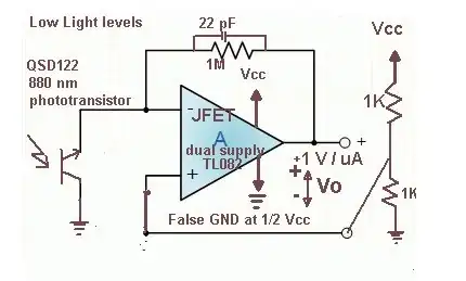

I am setting up a high sensitivity light detection circuit and came across this thread just a bit ago:
Phototransistor transimpedance amplifier
Within it was a response with this image: enter image description here
My question is this: Should the phototransistor in the diagram above be connected to the true ground coming from the power supply or to the virtual ground?
Thank you and I know this may seem like a newbie question and perhaps similarly asked in other threads, but it doesnt seem to have been explaind in my opinion.

First of all the phototransistor seems to be drawn upside down, the emitter should be at the negative side.
In your circuit, the inverting input is held at the virtual ground potential by the feedback loop. In order for the output of the opamp to be made to go positive, current must be drawn from the circuit node to which the inverting input is connected. This will cause the inverting input to tend to go negative and the output voltage will rise, causing current to flow (to the left) through the feedback components thereby restoring the voltage at the inverting input terminal. In order for this to happen the phototransistor must be connected to a more negative potential than the virtual earth. The "true ground" would be a suitable point. If it were returned to the virtual ground, then there would be no potential difference across the transistor and the circuit would not work.

It has to be tied to your true ground, not virtual ground. The virtual ground is used by your opamp

COMPLETE REWRITE:
I kinda cheated last time by using floating voltage sources as the opamp inputs.
Here's something a little closer to the truth, using the phototransistors in optocouplers.
Both ways work, (grounded and pseudogrounded) but the grounded version has a lot more gain as evidenced by the difference in the LED ballast resistors.
Version 4

  • How does this work when the phototransistor is referenced to virtual earth? The only way I can see that working is if the phototransistor exhibits significant photovoltaic effect. Is this the mechanism you are thinking of for this circuit configuration? – user1582568 Feb 24 '16 at 16:45
  • No. All I was pointing out was that if a voltage source is connected between an opamp input (- in this case) and either a ground or a pseudoground related to the opamp, there will exist a potential difference across the opamp inputs which the opamp's output will servo to cancel out and thereby provide an output. – EM Fields Feb 24 '16 at 20:32
  • Yes, if it is a voltage source that's true, but this is a phototransistor – user1582568 Feb 24 '16 at 20:34
  • Yes, but it's acting like a voltage-variable resistor in a voltage divider, (with a potential across it) the other resistance being the feedback resistor from the opamp's output to its inveting input. Check out my edited/new answer. :) – EM Fields Feb 24 '16 at 23:12
  • Ah, but it would not work if all the components were ideal. I suspect the tiny amount of response that you are getting in your simulation is due to the opamp bias current providing a little offset and so biasing the phototransistor. In the ideal circuit the opamp output would be at the virtual earth potential and there would not be any voltage across the feedback resistor. – user1582568 Mar 01 '16 at 13:28
