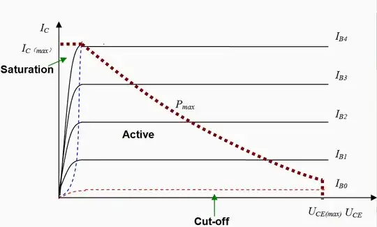

Since I have no idea what the amplitude is for \$V_B\$ or what the magnitude is for \$R_B\$ are, I went googling around for a graphical diagram that would show me the relationship between \$I_C\$ and \$V_{CE}\$ for a given \$I_B\$. Wikipedia yielded this: This graph confuses me, because it seems to suggest that, for a given \$I_B\$, reducing \$I_C\$ will reduce \$V_{CE}\$ (which is the same as \$V_o\$ in my circuit). Furthermore, while I can find several other versions of this graph online, I have yet to see on that labels the \$I_C\$ axis with units--is a typical order of magnitude for \$I_{C(max)}\$ in the \${\mu}A\$ range or \$mA\$ range or some other fractional amperage? Finally, my gut was telling me that I might be able to put in a resistor in parallel with \$R_C\$ to increase current to the collector in order to better bias the \$CB\$ junction, but the graph seems to suggest the opposite--I should put a resistor in series to decrease the current if I want a \$V_o\$ which is more consistently closer to \$0\$ when \$V_B\$ is high.

  • *for a given \$IB\$, reducing \$IC\$ will reduce \$VCE\$* **Correct**, or \$IC\$ reduces when \$VCE\$ becomes smaller. You mean the part left of the blue dotted line ? This region is called **saturation**. \$VCE\$ is not high enough to allow the BJT to determine the current (as is the case to the right of the blue dotted line). – Bimpelrekkie Feb 23 '16 at 16:05
This is the expected behavior. Although we usually express it the other way around: Increasing \$V_{ce}\$ increases \$I_c\$, although this effect is small in the active region.
I have yet to see on that labels the \$I_C\$ axis with units--is a typical order of magnitude for IC(max) in the μA range or mA range or some other fractional amperage?
Typical range is from 10's of mA to a few amps. A transistor only able to carry microamps would have limited applications, although such a thing might exist, for example within an integrated circuit. In the power industry there might be BJT's capable of carrying 10's of amps, however nowadays such things are more likely done with power FETs or insulated-gate bipolar transitors (IGBTs)
Finally, my gut was telling me that I might be able to put in a resistor in parallel with RC to increase current to the collector in order to better bias the CB junction, but the graph seems to suggest the opposite--I should put a resistor in series to decrease the current if I want a Vo which is more consistently closer to 0 when VB is high.
Correct, you should increase the value of RC in your diagram to obtain a lower output voltage when the input is high. However, you will have a difficult time achieving an output voltage less than about 0.2 V. This should not present a problem for your application since a microcontroller digital input will almost surely consider 0.2 V to be a logical 0.

  • If I am understanding your answer correctly, when \$V_B\$ is high (which if I was a betting sort, I would guess will be a TTL-level voltage like 5V or 3.3V, so plenty high to drive the base), the transistor should pull ~.98mA, because that's the current gain that will result in ~0.2V across \$CE\$? It won't be in some strange state if that current gain is much lower than it would be if the transistor was saturated? – Frank Feb 25 '16 at 14:02
  • @Frank, when the transistor goes into saturation, there's no longer a strong connection between the base and collector currents. Nothing limits the base current except the base resistor Rb. (Many learners misunderstand what causes saturation. See an [old answer](http://electronics.stackexchange.com/questions/51405/) of mine for more info) – The Photon Feb 25 '16 at 17:09
  • Also, current gain in saturation *is* much lower than in forward-active mode. In fact, gain is not well-controlled at all. Really, you should look at it as if the transistor no longer controls the collector current, rather the external circuit limits the collector current below what it would be in forward-active mode. – The Photon Feb 25 '16 at 17:19
