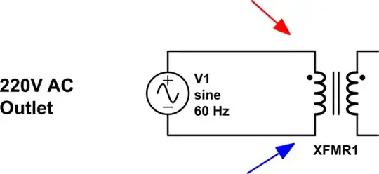

I bought a new transformer, and I was trying to measure the output voltage. I plugged the probes on 'VΩmA' (not 10 A) and COM. and set it to 750(not 100% sure if i put it on 750 or 200) ACV.
Then I put my probe on the right side of the picture, which is the transformer output, and I got no numbers reading.
Then I wanted to check if the outlet was working right, and put the probe like the picture. My outlet has only two outputs, with no neutral/hot labeling, just two of them and they are 60 Hz 220 VAC.
Anyway, as I put the probes like the picture, the multimeter made zipping noises and it didn't display numbers. Maybe it was shorted inside? I put it like the picture again, and the fuse exploded.

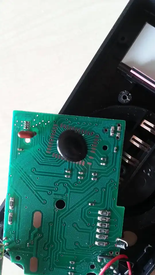

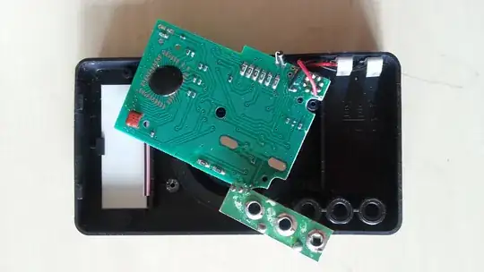

Well, some of you wanted the inside of that meter. So I'm uploading some of the pictures. The inside looked simpler than I expected...

  • There is actually some visible damage that hints toward a problem in your multimeter... See the edits in my answer... – zebonaut Feb 25 '16 at 10:25

  • "... and the fuse exploded." - Now that I look at your pictures again, it seems there isn't even a fuse in the multimeter. Or are you talking about a fuse on the secondary (or primary) of your transformer, *outside* of your multimeter? – zebonaut Feb 26 '16 at 09:01

    Do you still have the remaining pieces of the fuse (or fuse-and-holder assembly)? Might be worth posting, because the text sounds like your multimeter made the fuse pretty much explode right in your face?! So it's not just your multimeter that developed an internal short (like the title suggests), you also had *something else* explode?! – zebonaut Feb 26 '16 at 09:40
  • @zebonaut Actually I think I need to describe more detailed. 1. The multimeter made noise and started displaying weird numbers. 2. I had no idea, so I just put the probe on the same position again. 3. Maybe the multimeter was shorted inside it somewhere, so as i put the probe, the fuse exploded. So the explosion was because of the short.. –  Feb 26 '16 at 13:08

The layout of the traces, and of any wires and components inside the multimeter must of course be designed to withstand the voltages they are exposed to during normal operation and allow for some safety margin. The pictures you edited into your question look like your multimeter may actually have contained a small spark gap because of horrible manufacturing skills - one gets what one pays for...

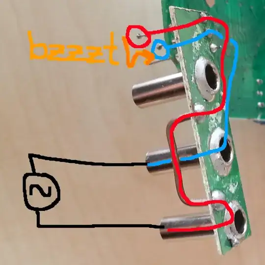

It appears that the three wires used to connect the main board and the banana socket board are (i) soldered with horrible quality and, more importantly, (ii) should have been clipped before the assembly was put into the enclosure. I guess the two top wires may have become bent while the instrument was put together and were really close to each other. Once you applied your transformer's voltage to the terminals, you probably ended up causing sparks between the wires. Note how the [10A] jack is connected to the [COM] jack by the shunt resistor (the big thing that looks like a U-shaped wire), so the middle wire can cause arcing to any of the two outer wires. By the looks of it, you had sparks between the top and middle wires, because there are little balls left from the arc's heat (sorry, i can't find an English word for Schmelzperle, maybe someone can edit).
So, yes, there is a possible piece of evidence that you used your multimeter the right way and you actually observed a fault caused by bad manufacturing.
What to do now?
Given you are a trained electrician (disclaimer, disclaimer ;-), you could clip the wires, fix the bad soldering, re-assemble the multimeter and chances are it will still work, maybe even better than ever before ;-)
It might be a very good idea, though, to limit the use of your repaired multimeter (or any similar model) to safe, low-voltage measurements, because it's worth considering...

  • Wow there was another thing related with this. that buzzing? zipping noise was from that! the two pins obviously seems to have melted. BTW actually I found it on internet(the same multimeter) and it costed 5 dollars.. so maybe I could just buy new one?? although thanks for the answer. I didn't know that at all. Now I think the reason of failure has all been figured out..? –  Feb 25 '16 at 10:41

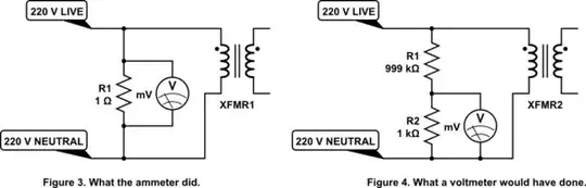

Figure 1 shows what you did. You connected a milli-ammeter (250 mA) across the mains. It probably has a resistance of about 1 Ω which, by Ohm's Law, would cause a current of \$ \frac {V}{R} = \frac {220}{1} = 220 A\$ to flow very briefly before the fuse blew. Meanwhile the digital electronics which was expecting to see about 250 mV across the 1 Ω resistance (the shunt) would have seen almost mains voltage. This almost certainly damaged the electronics unless it is a high quality meter with excellent protection.
Figure 2 shows what you should have done. i.e., Switch the meter to volts and use the V and COM sockets.
simulate this circuit
Figures 3 and 4 show a hypothetical multimeter circuit. The meter is full scale when 250 mV is placed across its terminals.
  • To use it as a 250 mA ammeter we use a 1 Ω shunt resistor, measure the voltage drop across the resistor when current is flowing through it and read that off as mA. Placing 1 Ω across the mains causes a very high current to flow.
  • To use it as a 250 V meter we need to divide the voltage by 1000:1. This we can do with a pair of resistors. In this case I have chosen the pair to give 1 MΩ total resistance - similar to many digital meters. At 250 V across the probes the voltage is divided down to 250 mV across the meter.
Figure 3 circuit will blow the meter. Figure 4 circuit will work and survive.

I've got also a DT-830B, but mine is different. It is also for CAT II measurements and it has a lead fuse inside:
DT-830b front
DT830b open
I can't see a lead fuse in your DT-830b and share Bobs opinion/answer.
rageye
    Is it just me, or does that fuse not look dangerously close to the 9V cell? In fact, the 9V looks like it's suffered damage as a result of incidental contact and is bulging and in danger of bursting. I wouldn't trust this DMM any further than I could throw it... – J... Feb 25 '16 at 11:24
  • One thing I mentioned in my answer that I think you should also take note of is the first paragraph. Despite the rating claims on your meter, it's still lacking the backing of a known brand (i.e. knowing *who* manufactured it). Basically, the problem is it's pretty easy for a factory to print markings on the case without actually making sure the device satisfies those ratings. There are, of course, other ways to verify - third-party certifications like a UL listing. – Bob Feb 25 '16 at 13:08
  • @J... There is a isolation between the fuse and the 9V cell (the thin grey line). – rageye Feb 25 '16 at 18:41
  • @rageye Yeah, I see it now... had to stare at it for a minute. Still seems a bit scary, that little piece of paper 0_o – J... Feb 25 '16 at 18:46
    @Bob and J... : You are right, this DMM isn't save. In Germany it has been rated as a dangerous product because at 1270 V applied to the sockets there is a flashover. For isolation it must withstand at least 2210 V AC. Source: [http://www.baua.de/de/Publikationen/Fachbeitraege/GPSG-1-2007.pdf?__blob=publicationFile&v=6] See page 62 (it's in German). – rageye Feb 25 '16 at 22:33
  • @rageye Thanks for providing the link. There even is a nice video with an exploding DMM. I have edited my answer after having found it, providing the link... – zebonaut Feb 26 '16 at 09:50
  • This goes to show we need more stringent regulations here in the US. Perhaps the CPSC would do something about it... – bwDraco Feb 29 '16 at 15:47
