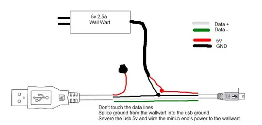

You would have to feed D+/D-/GND to the PC, not just D+/D-. This would allow the PC to communicate without supplying power.
It's then possible to split off the +5V cable and GND to an external +5V power supply. In order to do this, you would need to split open the cable where you want to splice off your power supply, preferably without damaging the D+/D- cables as these are controlled impedance and don't particularly like having random bits of cable or solder joints in them.
Once the outer insulation is split open, you can remove a small section of insulation from the GND cable and solder on the GND from your second cable. Then also cut the +5V cable and solder it instead to your second cable.
Finally, carefully cover everything up with heat shrink tubing or similar.
Basically you would have something like:
Cable Splicing

  • So you are telling me that I would have to make two cables from one GND and then connect one half to PC side and the other one and +5V to power supply? – Carl Johnson Feb 21 '16 at 16:54
  • @CarlJohnson if you take a standard USB cable and leave the D+/D-/GND cables intact, then you can splice on your the GND cable for your supply to the existing one by soldering it on. See my edit – Tom Carpenter Feb 21 '16 at 17:02
  • So I take off the isolation from GND from the cable I will use for data and cut the +5V then solder GND from power supply to the existing GND from data cable (that was not cut) and solder +5V to the micro USB side of data cable and it should charge from power supply and be able to exchange data with PC? – Carl Johnson Feb 21 '16 at 17:10
  • @CarlJohnson yes. – Tom Carpenter Feb 21 '16 at 17:13
