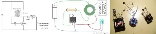

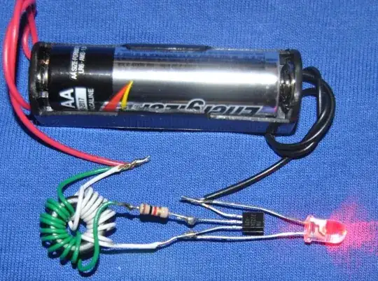

If you genuinely want lowest cost then a properly engineered version of the Joule Thief is a good candidate. I use that name as it will lead you to many many variants but the original form is not very efficient. However, once you have the idea you can look at the options and choose one.
The "Joule Thief" is a one transistor self oscillating boost converter using an inductor main winding plus an inductor feedback winding. For DIY use you could build one for free from almost any modern scrapped electronic device or if buying new or surplus parts could build one with 10 to 20 cents of parts.
Here is a good example of a DIY Joule Thief page
The composite image below is made of 3 images from the above page:
Others - You can build boost converters with one transistor and two separate inductors - advantage is no need for two windings. And The classic Colpitts oscillator uses an untapped inductor.
A number here and
Other versions:

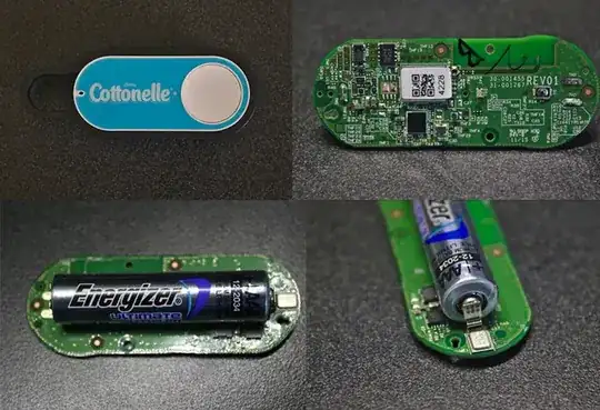

The Dash Button
amazon dash button

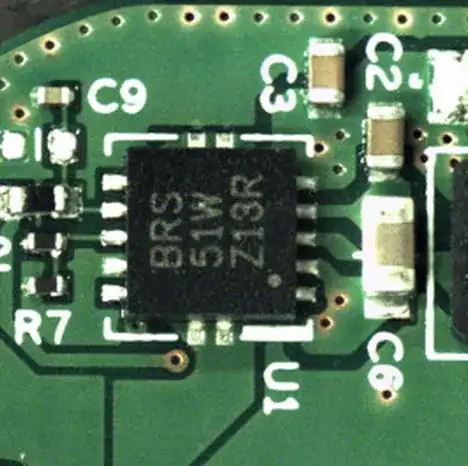

The [Amazon] Dash Button operates at 3.3 V boosted from the battery’s nominal 1.5 V, drawing 200–300 mA from the battery when on and 2.3 μA when in sleep. This means the ~1200 mAh battery should be able to power the device for at least four hours while on and decades while in sleep. Since the button is only on for a few seconds when activated, it can probably be used close to 1000 times before the battery dies. Thus, the button should become obsolete long before the battery is depleted.
boost converter
[It was] pointed out that U1 is probably a TI TPS61201 boost converter; the footprint, package markings, and pinout seem to fit.
From Amazon Dash Button Teardown
cwd
  • 375
  • These are more than a dollar each per Octopart and will likely not meet the "Least Expensive" need to satisfy the question. But you're on the right track -- if you find a cheaper chip. – MicroservicesOnDDD Apr 30 '22 at 16:40
