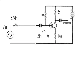

The word "high input impedance" is always related to the amplifier (audio intermediate frequency power amplifier... etc.)
So let's consider the following circuit:
The input voltage \$V_{in}\$ has an internal impedance (\$Z_{in}\$) this voltage injected to the base of transistor to amplify the signal. We calculate the voltage across \$Z_{in}\$, called \$v\$ as follows:
$$v = \frac{V_{in} Z_{in}}{Z_{in} + Z.V_{in}}$$

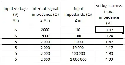

If we take \$V_{in}=5V\$, \$Z.V_{in}=2,000Ω\$, \$Z_{in}=10Ω\$ we get:
$$V=\dfrac{5 \cdot 10}{2,000+10} = 0.02V$$
That's a very low voltage compared with the input voltage.
If we take \$V_{in}=5V\$ , \$Z.V_{in}=2000Ω\$ , \$Z_{in}=1,000,000Ω=1MΩ\$ we get:
$$V=\dfrac{5 \cdot 1,000,000}{2,000 + 1,000,000}=4.99V$$
That's a good voltage compared with the input voltage.
Let's see some value of the input impedance in the table below.
The answer is the high input impedance is good for the amplifier circuit to have a good amplification of the input signal other wise we get low voltage in, so low amplification.
