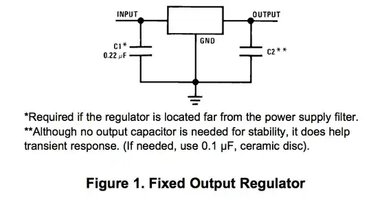

How does a cap on a regulator output improve transient response? Is this cap not more appropriately drawn next to the load where it is not being defeated by intervening trace inductance? Or does this output cap serve a different purpose than the typical bypass caps seen on a digital IC power supply pin?
http://www.ti.com/lit/ds/symlink/lm340-n.pdf

  • Yes, put the capacitor next to the load. Better still, put both the capacitor and the regulator next to the load (unless you're trying to keep the regulator's heat away from the load). –  Feb 13 '16 at 23:51
    OK, so the output cap has nothing to do with the 7805 per se (e.g. compensation), but is just your usual bypass capacitor that would normally be placed at the load. This raises the question of why it would be mentioned in the application circuit at all, since the application circuit of just about any IC will also call out bypass caps on its VCC pins. If one blindly follows both application circuits, and the regulator is placed at the load, you wind up with doubled up bypass caps right next to each other. – mhz Feb 14 '16 at 12:22

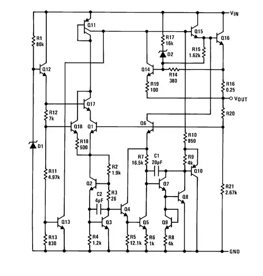

The regulator has a certain output impedance (Rout; given mostly by RE of Q16, R16 and R20). When the regulator is in regulation, this output impedance is reduced by the loop gain -- so at low frequencies (i.e. slowly changing loads), the regulator regulates well (i.e. accurately) -- VOUT is precise and doesn't change as load current changes.
However at time scales faster than the loop can respond (i.e. beyond the loop bandwidth), the output impedance is just the above expression. Thus a load current step will result in an output voltage step of deltaI*Rout until the feedback loop can 'correct' it. The capacitor at the output is in effect in parallel with this Rout, thus (at higher frequencies) keeping the effective Rout low, so load current steps don't result in load voltage steps.

Such output caps are for Smoothing for very quick current droops. and ceramic caps for even much faster current noise in the regulation line such as if the sensing element is not to be perturbed by linearity loss
