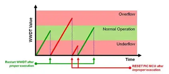

I agree with the answer from MaximGi. Here is just an alternative wording:
  • Standard watchdog: only asserts its output when the watchdog timer overflows, not when it underflows.
  • Windowed watchdog: asserts its watchdog output if the watchdog timer overflows or underflows.
Picture below from Microchip describing a windowed watchdog: enter image description here
