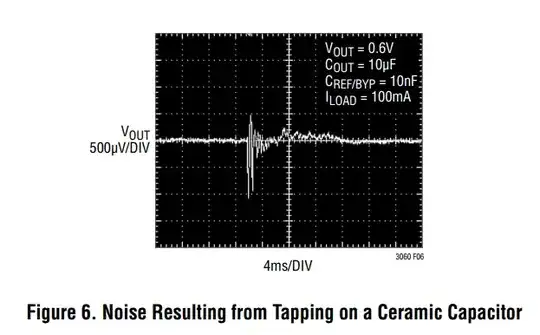

Last edit -- the piezoelectric effect your teacher referenced is the somewhat unique characteristic of ceramic capacitors where physical stress / strain / vibrations will actually induce a voltage. This is due to the physical stress actually deforming the lattice structure of the dielectric (barium titanate). Tapping a ceramic capacitor with a pencil and monitoring its output with a scope probe should show the noise:
LT3060 Datasheet Figure 6
