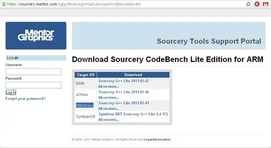

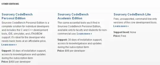

However, they do a decent job of getting you to the commercial version, which, by the blessed GPL, contains links to the source. I got to it by following the menu set Products -> Embedded Software -> Sourcery Tools -> Sourcery CodeBench and scrolling to the very bottom to find the personal, academic, and lite versions:
Those links direct you to the mysteriously difficult-to-navitage pages https://sourcery.mentor.com/sgpp/lite/arm/portal/subscription?@template=lite.
The subscription breadcrumb in the URL and repeated suggestions to log in are for paid support and trials of the IDE. Just ignore them.
From that page, you'll see something like the following, with a link to the EABI version (An acronym for the ARM Extended Application Binary Interface, use this if you want to program bare-metal apps) as well as versions which link against the libraries that will be installed with other operating systems.
Clicking on the EABI "All versions" link from this page brings you to https://sourcery.mentor.com/sgpp/lite/arm/portal/subscription3053, the site you linked in your comment.
