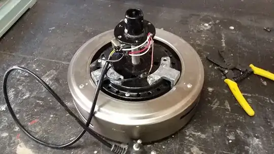

I've managed, through the help of others here on Electronics StackExchange to get a ceiling fan motor running, at least at one speed, and in the right direction.
Ceiling Fan wired up and running
I want to enable 3 speed settings on the motor. How can I enable speed control of the motor?
