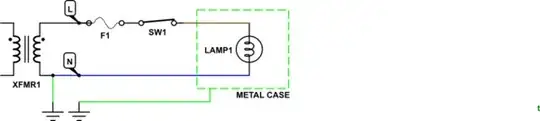

Figure 1. Supply transformer supply and earthed appliance.
Yes Live is the supply, Neutral is the return and the Earth is protection. Normally there is no current in the earth wire but if, for example, a live wire fell off inside the appliance and contacted the metal there is a risk of electrocution. Earthing the appliance prevents the case rising to dangerous voltages. In the event of a sever fault a high current may flow but the fuse will then blow, making the system safe.
Double insulated devices don't need to be earthed so a two-pin plug is adequate.

  • I can see from your schematics that there are two ground symbols, can't we just have one? – Jack Feb 07 '16 at 19:33
  • @MaryE I *think* usually ground and neutral are connected like that, so yes - just imagine the bottom green wire going left a little bit and connecting to the left ground symbol instead. But are you asking why the metal case doesn't just connect to the neutral wire? – user253751 Feb 07 '16 at 23:26
  • @MaryE: Connection varies from country to country. In Europe it is normal to have the neutral bonded to earth at the distribution transformer. The house earth is local to the house and the earth or ground is use as the return path between the two in the case of an earth fault. That's why I have them separated. There can be a neutral to earth link at the building incoming supply also but I haven't shown that for clarity / simplicity. – Transistor Feb 08 '16 at 00:04
