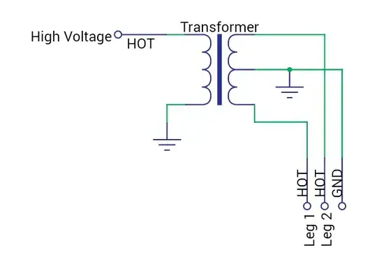

2: Because of the way the power is "transformed" from single-phase high voltage on the transmission lines to split-phase 220V coming into your house (see image below), the power always looks for the "shortest" path to ground.
Transformer Schematic
This path is usually from the "hot" pin on an outlet, through your appliance, then back through the "neutral" pin on the outlet. Just in case (in case someone connected the wrong wire to the neutral pin), though, any part of an appliance that's metal and expected for you to touch is connected to the outlet's "ground" pin, to make sure there's no "hot" voltage on it to shock you.
