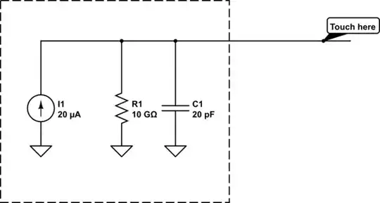

A Van de Graff generator can only deliver microamperes of current continuously, so the voltage was no longer 200kV or whatever after he touched it. It was probably less than 1 volt.
If you want to look at it more technically, the generator is like a constant current source of something like 10-50uA (wild guess) feeding into a capacitor and some leakage to ground (corona discharge) that occurs at high voltage. Discharging the capacitor of (the hemisphere at the top has some capacitance) and you're left with just the microamps of current, which is not remotely enough to be dangerous.

  • This [source](http://www.nuffieldfoundation.org/practical-physics/van-de-graaff-generator-safety) states around 0.5J of energy max stored on the domes of a school-grade VDG. That equates to about 25pF @ 200kV. 1J is required be rather dangerous according to that. – Tom Carpenter Jan 29 '16 at 03:59
  • So ohms law is still applied, the voltage just lowers, Thanks for your answer! – Rhezner Jan 29 '16 at 04:02
  • @TomCarpenter According to [what this source says about IEC61010-1](https://www.physicsforums.com/threads/at-what-capacitance-do-hv-capacitors-become-dangerous-to-human-touch.688975/) 0.35J is considered safe, so I guess they're on the edge of what is 100% guaranteed always safe for all humans regardless of health. Thanks for the reference, I reduced the capacitor in my 'typical model' which was based on a [14" (350mm sphere](http://deepfriedneon.com/tesla_f_calcsphere.html) – Spehro Pefhany Jan 29 '16 at 04:20
