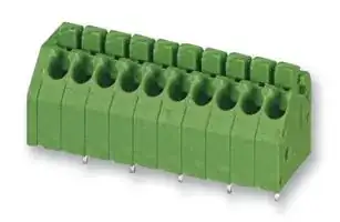

I need to decide what connector to use on my PCB to connect low power wires. Among the available options on Farnell/Mouser etc. The price and size are almost similar.
I wonder if using a screw terminal or a push-in terminal would be better for a vibrating environment?

  • NB: In some manufacturer's terminology, "Push-in" is different to Cage-Clamp (which is also known as Spring-Clamp or Spring-Cage). Push-in terminals don't need a tool for inserting the wire - you just "push in" the terminated wire and it clamps automatically. You release the wire by pressing a small button with a tool. Cage-Clamp connections need a tool for both insertion and removal of the wire. https://www.phoenixcontact.com/online/portal/gb?1dmy&urile=wcm%3apath%3a/gben/web/main/products/subcategory_pages/Terminal_blocks_P-15/ – sandyscott Dec 04 '20 at 11:40

  • Look at the photos in the OP. He's using PCB soldered terminals. You're answer as it stands is not relevant to the question and doesn't address his question of screw or push type. – Transistor Jan 28 '16 at 18:11
  • ...added example images of PCB soldered terminals, similar to OP photos. – Robherc KV5ROB Jan 28 '16 at 18:34
  • They're photos of plug connectors but OP isn't using plugs. He's wiring directly to fixed terminals in the PCB. Your answer is about latching connectors (which in all your examples use crimp pins). OP doesn't want crimps. OP wants screw or cage-clamp terminals for stripped wire ends. – Transistor Jan 28 '16 at 19:11
  • @transistor However, the OP can solder plugs on the wires, right? :) I see this answer as one that provides a good alternative. – yo' Jan 28 '16 at 19:28
