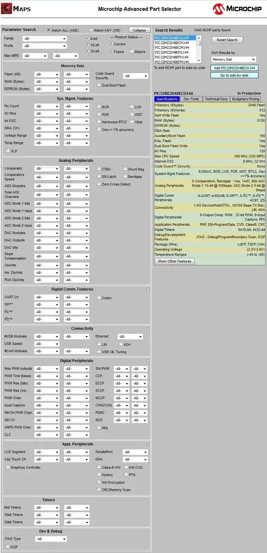

Microchip is another company that has a complete line of microcontrollers -- over 4,000 stocked at Digi-Key, including all package variants. Like TI, they span the gamut from 8 bit to 32-bit:
~2700  8-bitters: from 384 bytes Flash and 16 bytes RAM to 128 KB Flash and 4 KB RAM
~1000 16-bitters: from 4 KB Flash and 256 bytes RAM to 1 MB Flash and 96 KB RAM
 ~500 32-bitters: from 16 KB Flash and 4 KB bytes RAM to 2 MB Flash and 512 KB RAM
Note the smallest is spec'ed in bytes, not KB.
They range in price from 35¢ to $13.36 in single quantities. I imagine the lowest priced ones may go for under 20¢ in large quantities. Maybe even 10¢ for untested ones (where the customer does acceptance testing instead of the manufacturer). The cheapest 32-bit ARM is twice as much in single quantities at 76¢. For a high volume product, that is a big difference. The PIC10F200 is the cheapest µC of all the nearly 15,000 that Digi-Key stocks.
Microchip also has an excellent reputation for maintaining stocks of its older µC's (listed in the product selector below as "Mature"), which is another thing to consider.
How to make sense of all of that? Use a product selector. Digi-Key, Mouser and other distributors have fairly good ones, but they don't include all parameters (Digi-Key's µC product selector has less than 20, the table below has over 50). Microchip (and I imagine other manufacturers) have more extensive ones, such as the one below. Note that you can give ranges for almost all of the parameters:
