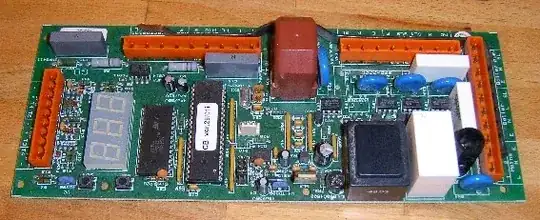

This is a "wet" temperature sensor for a Boilermate 2000 thermal store. The pin connectors are inserted into a plastic plug that connects to the control board (see 2nd image).
The pins do not stick out from the plug (see 3rd image which shows that the main pins are on the PCB).
Are the pin connectors some sort of standard part? If so, what are they called?
Pin connectors Boilermate 2000 PCB connected Boilermate 2000 PCB disconnected

If I'm reading your photos correctly the wire ferrules are held in cage-clamp terminals on the PCB connectors. The ferrule pins do not stick out the other side of the connector.

  • Great answer, thank you. Yes, the PCB plugs have "jaws" that can be opened, to allow new wires to be added (which is what I need to do). It's interesting that you say the terminals can grab stripped wire. I'm hoping I can do that in this instance, as I don't want to have to buy a ferrule clamping tool! – James Jan 24 '16 at 09:10
