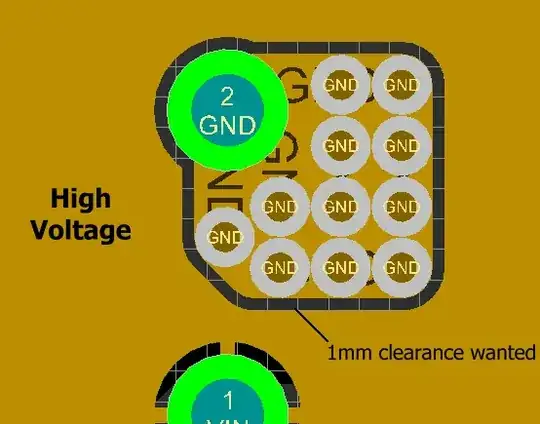

In Altium, when I draw a polygon, it automatically leaves a gap around copper of a different net. However, my Vin net is high voltage, and needs to have a 1mm clearance. Therefore, If I draw a Vin polygon, it needs to leave a 1mm clearance between itself and other nets. And if I draw a polygon of another net over a Vin via, then, again, it needs to leave a 1mm clearance.
I have tried setting the design rules, but to no avail.
How do I get polygon to automatically leave 1mm clearance when one of the two nets is Vin?

Polygons in Altium are tricky.
The solution to your problem is to use the rule InPolygon instead of IsPolygon.
As I understand it, Altium treats polygons as kind of a "meta" descriptor, internally. A "Polygon" object contains the polygon outline. The outline itself is matched with the InPolygon rule (which is what you want).
This is of course made far more obnoxious by the fact that IsPolygon is a valid rule token, so your rule will seem to be correct, and even pass the rule-checker, but silently fail when you try to actually repour the polygon, since the IsPolygon rule matches against something else.
Also, from your included image, you are trying to make a Power Plane Clearance rule affect a polygon. I think you may need to change that to a Clearance rule (Under the Electrical grouping in the rules window, since Altium's polygons are not planes.
This is off the top of my head, ATM. It's been a while since I needed varying plane clearances in Altium
Don't ask how long it took me to figure this out myself....

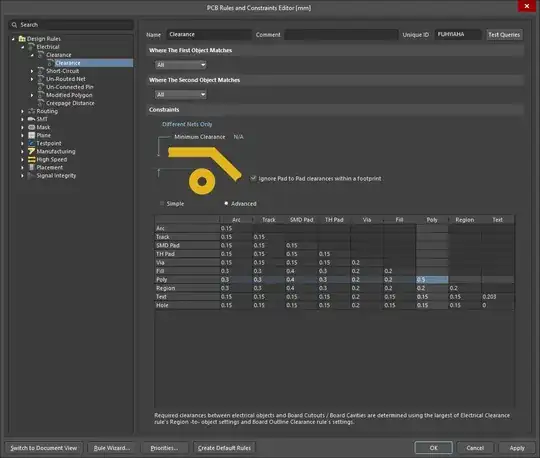

Solution for Altium 21.9
I was looking for the answer to this in Altium 21.9 and came across this post.
Here's the updated method:
Go to your design rules ("Design" > "Rules") and under "Electrical" > "Clearance" > "Clearance" (or whatever your default clearance rule is called), select the "Advanced" radio button in the "Constraints" section.
Now you will have box in the rule matrix for Poly/Poly clearance, where you can set your desired gap.
"Design Rules" window showing the relevant clearance rule settings
