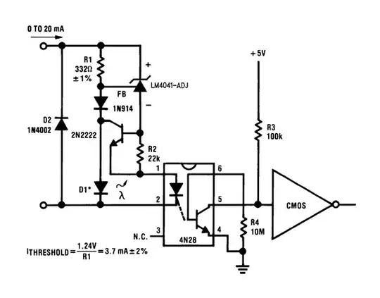

This answer is by no means complete, but it is a start when thinking about detectors with galvanic isolation:
This detector is a design by Bob Pease, and there's a fairly recent, updated version of it, too.
I hope fair use covers adding this picture; source: electronicdesign.com/Content/UserStorage/17928/63063.jpg
This image is just a teaser, please see the complete text in the link to the online article in electronic design magazine above.
The improvement over using just a resistor as a current-to-voltage converter and having to cope with its significant power losses is that the suggested circuit uses a voltage reference that limits the power through the sensing resistor.
Here's some suggested reading for the transmitters, quoted from National Semiconductor's application note 300 (liked above): "Circuits for making 4-20 mA transmitters are found in the LM10, LM163, and LH0045 data sheets."
Others are invited to edit this answer and cover other aspects of the original question.

  • I'm playing with this circuit in LTspice to understand it... however it seems optimized for fault detection and not 4-20mA readings. If the current off the sense resistor is limited, the ADC reading does really odd things. It would seem to me to be easier to just use a smaller resistor in the first place... ? Isolating the receiver doesn't seem to be as big a problem as isolating the power. If I've isolated power, using that to isolate the receiver should be easy. I may ask a separate question about multi-output isolated supplies. – darron Oct 24 '11 at 15:05
  • For transmitters, I could use the AD421 and isolate the digital inputs. The LM10, LM163, and LH0045 seem to be too old, but the datasheets are awesome. – darron Oct 24 '11 at 15:06
