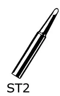

I have an ordinary Weller soldering iron with a conical tip, which I fear does not transfer much heat to the area. Since I am planning to do a dead bug project I thought it would be better to get a flat on the tip of the iron, possibly by grinding it so it looks like this:
However, I am told that this will not work because the tip is not actually solid, but is plated, and if I grind it, then the plating will get ground off. Is this true?
Can I just buy an alternative tip and then install it somehow on the iron, or do I need a special kind of iron that supports interchangeable tips. The type of station I have is an older analog station which is one piece with the holder and sponge on top and a strip of LED lights that indicate the temperature.

DON'T grind your soldering tips. It will ruin them. Good quality tips are made from copper with a thin layer of iron or another metal on top. The copper conducts the heat, and the other metal prevents the copper from corroding. You can buy new tips of any size and shape you want. They are pretty cheap. There is usually a tiny screw on the side of the soldering iron near the hot end that lets you change the tip.

Yes solder tips are not solid, they are just plated. So you do not want to grind it down. That will remove the plating and then solder will no longer stick to the tip rendering it useless. However, most soldering irons have replaceable/exchangable tips, and they do make a chisel or flat tips you can purchase here. I don't think you will have any issues finding tip that is exactly what you are looking for.
