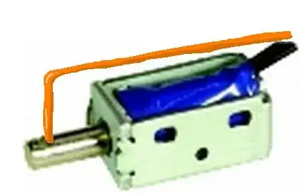

You can get essentially the same result by adding a non ferrous* extension to the core so that when it travels inwards the extension moves outwards.
See diagrams below:
Diagrammatic -

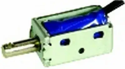

As typically implemented:
The above images are from this page.
If the coil end at the "pushing" end is open it will be relatively easy to insert something which can b pushed. If it is closed you may or may not be able to add a hole. Be careful not to drill through coild or wiring.

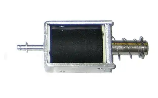

Many for sale - some of these may LOOK like genuine push type but it is almost 100% certain that they will be pull type with an extension.
Dismantled:

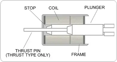

I know this is an old thread, but If you don't want to buy a new solenoid, you have a couple of things you can do.
  1. Add an attachment like the one in the following pic:
    diagram
    Note: The object being pushed will be on the other side of the thrust pin.
