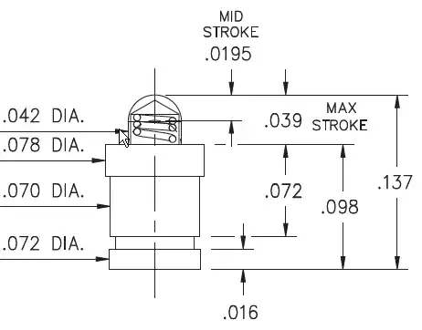

A spring clip would work. Depending in what exactly you want to do with it, you might be able to use a gold-plated spring loaded pin.
Typically one would design the holder so that the pin is depressed to about 50% of the stroke.
