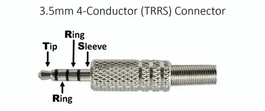

An earphone jack looks like this (parts are labelled.)
The tip, two rings and sleeve are called conductor points. The black rings are insulation rings that separate conductor points. An earphone consists of many parts (a microphone, two earpieces, etc.) Each of the parts are connected to a separate conductor point. The only difference is in "which part is connected to which point".
There are two standards for this. The first, known as CTIA (Cellular Telephone Industries Association) or American Headset Jack (AHJ) standard which has the microphone connector point on the sleeve end (i.e. microphone wire is connected on sleeve end,) with the signalling (or ground) connector on the second ring. Apple uses a similar connector arrangement. The second one is OMTP (Open Mobile Terminal Platform) standard. Nokia & Lenovo Mobile initially adopted this standard. It has the signalling connector (ground) next to the sleeve, with the microphone connector on the second ring. See the image below:
IP and NK switch is basically a switch between the two standards ie CTIA and OMTP thus making the earphones universal.
