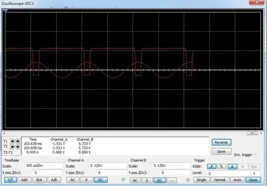

The pulse like signal is the output that I got from the amplifier. Similar results were obtained when I used BC107 transistor. This result is very frustrating.

    What you see has **nothing** to do with the values of the resistors. What you see is the behavior you get when you **severely overdrive** the input. You are applying **way too much** input signal to this circuit. Stay below 1 Vpeak-peak and it should work properly. If your goal is to design your own audio amp. you have a **very** long way to go. You will need to understand how this circuit works, understand why changing the resistors would not help and much much more. Designing a circuit is not putting something in a simulator and hoping for the best. Designing something required knowledge ! – Bimpelrekkie Jan 15 '16 at 14:47
    @FakeMoustache - your comment reads like it contains an answer. Have a 'Friday +1' on me. – gbulmer Jan 15 '16 at 14:50
    "This result is very frustrating." This is cause by you not understanding what you're doing. Trust me, the fun begins when you know what you're doing and saying: "AHA ! That's how it works !" :-) – Bimpelrekkie Jan 15 '16 at 14:51
    @gbulmer Indeed, now reading it back, indeed it **is** an answer :-) I was doubting if he's really putting that much signal in, now I see that its 10 V !!!! I'll make the comment into a proper answer. – Bimpelrekkie Jan 15 '16 at 14:54
What you see has nothing to do with the values of the resistors ! What you see is the behavior you get when you severely overdrive the input. You are applying way too much input signal to this circuit.
Is that 10 V peak you're putting in ? Geez, the supply is only 9 V. If you want low distortion then the output swing can only be 2 Vpeak or so.
Stay below 1 Vpeak-peak at the input and it should work properly.
If your goal is to design your own audio amp. you have a very long way to go. You will need to understand how this circuit works, understand why changing the resistors would not help and much much more. Designing a circuit is not putting something in a simulator and hoping for the best. Designing something required knowledge and practice.
Update: Oops, my mistake, forgot to consider that CE of 100 uF, this will increase the gain. IF THE CIRCUIT WAS DIMENSIONED PROPERLY which it is not. This amplifier is wrongly biased, RC is too high driving the transistor into saturation.
This explains why you get the distorted output !
You will need to study a bit more to learn how to bias a transistor properly.
