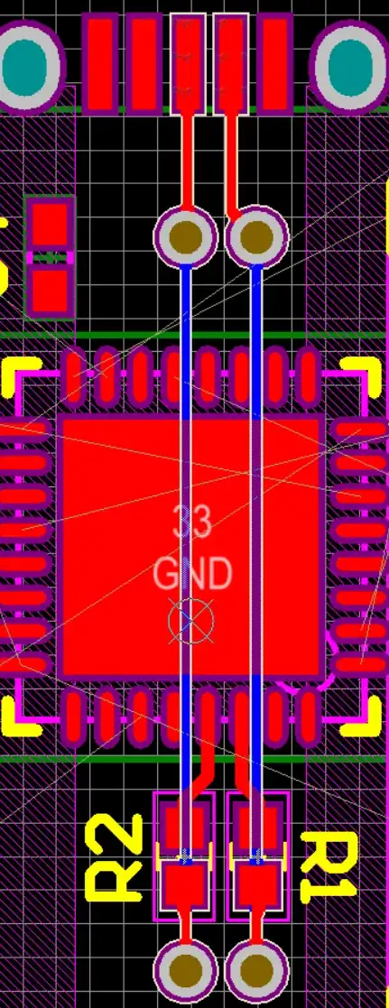

I'm making my second USB design, but the D+/D- pins on the MCU (atemga16u2) aren't in the right order for the micro B connector. What's the best practice for routing these to go the right way? My current idea is to rotate the atmega 180 degrees and route them under, but it feels like the traces are fairly long.
I could also drop one of the lines under the other, but I'm sure that would mess with the lengths for the differential pair.
This device won't go over Full Speed, so I can get away with less than perfect routing.
Routing under the MCU with vias

  • If you have enough space, keep the traces on the top layer and enter the connector from the other side. May be worth rotating the chip too. – Armandas Jan 03 '16 at 13:19
  • Do you mean the other side as in the bottom layer? Unfortunately I can't do that because of space issues. – monty Jan 03 '16 at 13:22
  • No, other side as in from the top (as shown in your image), instead of bottom, as you do now. – Armandas Jan 03 '16 at 13:23
  • At USB full speed you can get away with a lot. Vias certainly, 0805 or even 1206 0-ohm resistors to bridge one over the other on a single layer, etc. You already have inline resistors (as many designs do) so you can exploit those. – Chris Stratton Jan 03 '16 at 16:12

As an addition to Armandas' answer:
If you want to use vias, there is a simple trick to swap the lines: Rotate the vias by 90 degrees, i.e. put them "above" each other. If you enter both vias from the left in the top layer and leave them to the left in the bottom layer, both lines are swapped at no expense:

  • Could you provide a picture? I'm having a hard time envisioning what your describing. – vini_i Jan 03 '16 at 19:38
    @vini_i Here you go - added a drawing of traces. – asdfex Jan 03 '16 at 20:15
  • If everything was on the top layer, for example, would you then drop it to the bottom and them bring it back up with the cross over? – vini_i Jan 03 '16 at 21:50
  • In your specific case - hard to tell. I would try to go with the comment from Chris Stratton and use two big resistors and route one trace between the pads of the others resistor. The trick with vias is useful when you already have to go to another layer for other reasons. – asdfex Jan 03 '16 at 22:15
  • The via swap is excellent! I knew it was possible, but was struggling to wrap my head around how. – monty Jan 04 '16 at 17:06

  • You just beat me to it before I uploaded mine: http://i.imgur.com/nELi3dP.png Now, the datasheet says that should be a signal free zone - should I be fine? – monty Jan 03 '16 at 13:32
  • @monty I forgot that the microUSB is all metal. I would advise to follow the data sheet instructions whenever possible. – Armandas Jan 03 '16 at 13:54
