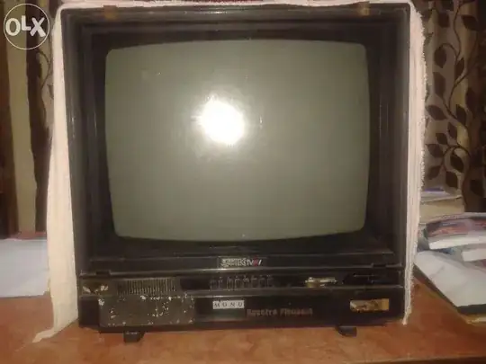

On electronic devices in the '80's, electronic malfunctions could sometimes be temporarily fixed by physically "hitting" the device.
For example, I once had a colour TV - "ECTV" (from Electronics Corporation of India ECIL) which would lose image. It was enclosed in a MDF/particleboard case, and as a kid I discovered that whacking it on both sides together would sometimes temporarily make it function correctly (for a few minutes to a few hours).
I think it wasn't purely physical (like an unseated component or dry solder) because it would stop working again after a while, and eventually it was fixed by a repairman replacing a capacitor in the power supply if I remember correctly (this happened around 1996 and my recollection is hazy).

  • Yes, I often wondered why folks would drape electronics with a cloth or knit cover when they had obvious vents. I thought it was an Indian thing :) Also, this is not a pic of my TV, which is long gone. I found this image on a local classifieds portal. – Pranab Jan 02 '16 at 07:17
