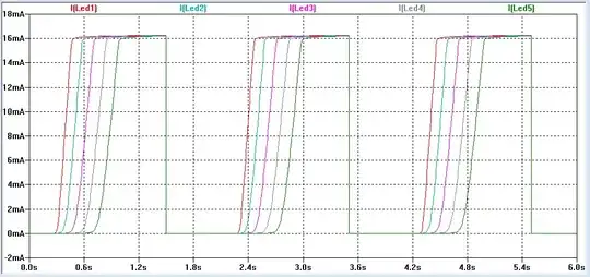

Improved LED Sequencer Circuit
This circuit has improvements over the posted circuit with the addition of a few more components. Still all simple components!! I did not include the astable oscillator in the simulation but that can easily be built with a 555 or a couple more transistors, resistors and capacitors.
A current source keeps the voltage ramp linear. An emitter follower buffers the waveform to the threshold diode stack and all transistors switch the same current levels to each LED.
The net result of this is that timing steps of the LEDs turning on are much more even and the timing parameters are easily adjusted to get desired timing, whether this be for a turn signal sequencer or for a light sabre flash up.
