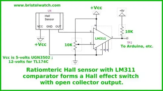

You may find that this new sensor outputs the inverse of the previous switch (functions backwards.) If that's the case, you can either get a different sensor with the inverse output, or use a variety of methods to invert the signal, such as an NPN transistor or FET. Better yet would be a comparator, as a setpoint or threshold can be specified, allowing better position control, such as figure 3 here. enter image description here

  • Your sample circuit is inappropriate. Since the Hall-Effect sensor is open-collector, the output of U4 would need a pull-up resistor. – WhatRoughBeast Jan 01 '16 at 17:36
  • Open-collector is explained in the preceding text. – rdtsc Jan 01 '16 at 17:39
  • True, but the schematic you provided does not include a pullup and will not work reliably as shown. You must not assume the OP is competent to realize that he needs to modify your circuit. – WhatRoughBeast Jan 01 '16 at 17:43
