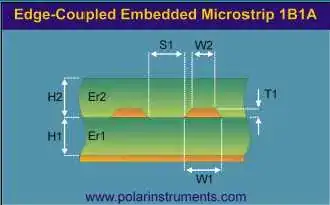

Now, let's say you're on an inner layer. The structure used here is generally edge-coupled embedded microstrip:
EC EMS
Similar to the first one, this one also factors in the distance to the nearest reference plane. A lot of designers favor burying their high-speed pairs on internal layers to benefit from the 'free' shielding of copper planes to reduce radiated emissions. Edge-coupled offset stripline is used when you have a signal layer sandwiched between two plane layers:

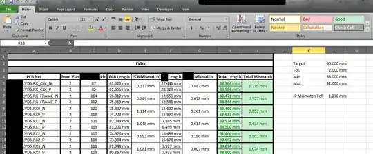

Length-matching does not affect the differential impedance and differs from protocol to protocol. There is intra-pair skew (P to N), and inter-pair/inter-lane skew (i.e. from PCIe Tx Lane 0 to 1) skew, where the latter is generally more tolerant of mismatch than the former. This is something you generally analyze near the end to add meandering or serpentine routing to get the members of the pair to meet the manufacturer specification. I use a script that dumps the raw net lengths to Excel, and then conditional formatting to let me know how I'm doing in meeting spec (redacted somewhat -- this is a board with a module that has some mis-match, and a carrier PCB that has mis-match):
Length-Matching

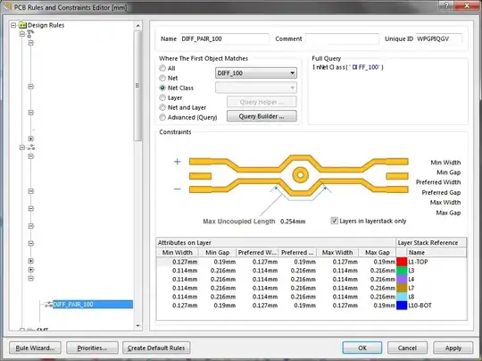

And here is an example of Altium set-up for 100 ohm differential pairs based on my vendor's recommendations:
100R differential routing
