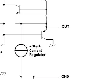

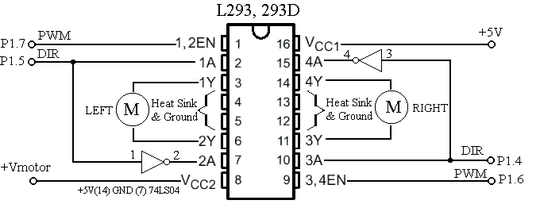

So upon looking at that motor, I believe you can not power it directly with Arduino PWM power, you need to buffer the signal because the PWM is directly powering the motor.
The problem here is that digital pins on an Arduino (Atmega 328p and all other microcontolers) are designed to only provide a small amount of current (typically < 20mA). What you really want is an H Bridge system, this is a chip or device that typically takes a single PWM signal and a direction signal. An example of one that would work for you is the L293, Sparkfun and Adafruit have both information and motor control boards based on these chips. The good news is that they still are made in DIP packages so you can buy some and drop them in a bread board.
Here is an example using the L293 chip mentioned:

  • I'll note before someone feels the need to point out that I knowingly simplified what an H bridge is... – MadHatter Dec 28 '15 at 15:24
  • It's not presently clear what functionality the poster really needs, but while conceptually simple, bipolar bridges like the L293 and L298 generally yield very dissapointing results unless used in a fairly high voltage (6 volts minimum, better 9 volts and up), low current applications. Most projects are better served by MOSFET bridges. – Chris Stratton Dec 28 '15 at 18:23
    I have only used these years ago back in college, do you have a more modern IC part? I also agree it is unclear what the op is looking for. – MadHatter Dec 28 '15 at 18:45
  • I think TI has one, the DRV8xxx? I have used the Rohm BD6221F in several projects as well -- supports direction control, PWM inputs and is a simple SOIC-8. That model is single channel, but is part of a family with various options: http://www.farnell.com/datasheets/610152.pdf – Krunal Desai Dec 28 '15 at 19:56
  • L293 on 5V I don't think so but: http://electronics.stackexchange.com/questions/108686/what-h-bridge-drivers-are-preferred-for-applications-controlling-a-low-voltage-m – Andy aka Dec 28 '15 at 23:55
  • @Andyaka Great source! Also I have done it on 4x1.5V Alkaline battery's, Looking back it probably was inefficient, but it was the only option given. Also the OP did not specify the running voltage. – MadHatter Dec 29 '15 at 00:06
