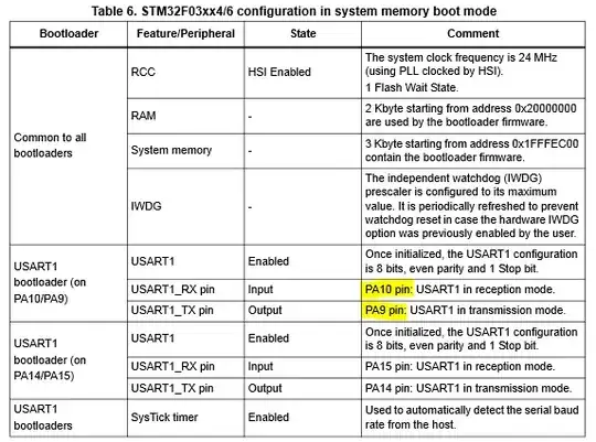

Starting from the reference manual of the STM32F030x4, page 45, Embedded Boot Loader section:
The embedded boot loader is located in the System memory, programmed by ST during production. It is used to reprogram the Flash memory using one of the following serial interfaces:
• USART on pins PA14/PA15 or PA9/PA10
• I2C on pins PB6/PB7 (STM32F070xx and STM32F030xC devices only)
• USB DFU interface (STM32F070xx devices only)
For further details, please refer to AN2606.
If you further read the other recommended document (AN2606) you will find out that you should go with PA9/PA10 because the bootloader is configured on those pins. (Or PA14/PA15 but your chip should be a TSSOP20 20-pin package if Boot0 is pin1, so there isn't any PA15.). Furthermore, you are right, no external crystal is necessary, the MCU is clocked from HSI.
For the hardware connection requirements, pull-up resistors are needed on TX and RX lines if they are not added on the host side.
You will also find information about the Boot0 pin and the nBoot1 bit (at this MCU Boot1 is not a pin but a bit in the User option byte).
The STM32F03xx4/6 bootloader is activated by applying pattern2
and pattern2 is:
Pattern2 Boot0(pin) = 1 and nBoot1(bit) = 1
Best would be if you could check the UART lines with an oscilloscope or logic analyzer, just to make sure. And check this software as well and read all related documents from ST.

  • Thanks for link to "reference guide", I am very silly girl to miss this document completely! I read about "option bytes" and it looks like nBOOT1 = 0 by default. So I'll need a way to overwrite it to proceed :( As about "this software" - it seems not to be supposed for running under linux, otherwise I'll surely try! – Alumashka Dec 27 '15 at 04:28
  • Oh no, I'm wrong! nBOOT1 should be 1 at factory default, if I understand reference guide correctly... So that should not be the problem. – Alumashka Dec 27 '15 at 06:37
