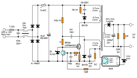

I found this schematic for a simple SMPS.
I want to use it to build a 24V/2-3A power supply for a soldering station.
How are the turns on the transformer calculated?
For the primary I can use
$$N = \dfrac{V_{in} \cdot 10^ 8}{ 4 f \cdot B_{max} \cdot Ac}$$
and get like somewhere around 30 turns.
But for secondary I don't get it right. In the schematic it says 5 turns for 14.4V. I get about 1-2 turns.
$$240V \cdot \dfrac{1.4}{14.4V \cdot 0.98} \approx 23 \implies \frac{30}{23} \text{ turns} = 1.3 \text{ turns on the secondary}$$
What am I calculating wrong? Should I use a 50% duty ratio for this type of SMPS? Even then, it does not get close to 5 turns.

  • Yeah, I just found out that my formula is wrong, at least for the secondary phase. How do I find VR ( Flyback reflected voltage) of this schematic? – C Cezar Dec 26 '15 at 11:02

  • @Andyaka, this one actually is rated for either 220Vrms or 120Vrms. Says so in the picture at least. – Dave Dec 27 '15 at 06:04
  • You need to factor in the duty cycle for your calculation. 50 % is theoretically posible, but you'd be suprised how low duty cycle most flybacks work at, especially wide range (100-240 Vac) at 240 V. Set up the circuit in LTspice and couple the inductors and you can play around and see what happens. A flyback transformer design is far more complicated than one might think. – winny Jun 20 '16 at 09:15
  • These self-oscillating SMPS have several problems. They need a minimum load which the 220 ohm resistor provides, and if overloaded can stop oscillating, burning up the drive transistor. Because of poor PWM width, they tend to run hot. –  Jul 01 '16 at 19:27
  • Self-oscillating flyback is not a good option for relatively high currents (i.e. >= 5A). Another thing to consider in the schematic above is the wire diameter chosen for secondary: Single 0.7mm for 5A is a terrible choice. 420A/cm² *(or 4.2A/mm²)* is a well approximation for both primary and secondary. So, for 5A output current, required cross sectional area for secondary wire is 1.2mm², not 0.4mm². Multiple wires should be used due to skin effect, or else the copper losses will be extremely high even if the number of turns is low. – Rohat Kılıç Feb 27 '18 at 10:52
A flyback transformer does not work like a conventional transformer. Theoretically, you can use any ratio. Practically, the ratio that gives 50% duty cycle is a good starting point because that tends to optimize the combined copper volume of the windings. Reducing the duty cycle has the advantages of lower output inductor ripple current and lower flyback voltage. A typical strategy is to set the windings ratio to near 50% duty cycle at the lowest operating voltage. Then for higher operating voltage, the duty cycle reduces, which gives the favorable effects.
In this design as given, assuming the minimum rectified voltage input is around 120V and the output desired is around 12V. Then the turn ratio for 50% duty cycle would be around 10:1, which gives 3T for the secondary. But apparently, the designer of the circuit had decided to start with a lower ratio and therefore a lower duty cycle. That gives lower output inductor ripple current and lower flyback voltage while the core volume might not make much difference because this is not very high power. It also lessens the manufacturing variability due to a very low number of turns.
The flyback voltage of the primary is simply: $$ V_{fb} = (V_{sec}=12.6V) \times \frac{T_{pri}=30}{T_{sec}=5} = 76V $$ This does not account for the extra spike due to leakage inductance. And be aware that as seen by the MOSFET, this is added on top of Vin, the rectified input voltage.
So for 24V output, the simplest is to trust the original design decisions and just double the number of turns to 10 (and change the zener diode to give you the correct regulated output voltage).

You use formulas that are seem difficult to understand. Here are simplified formulas I use:
\$ I_{pk} = 5.5*\frac{P_{out}}{Vi_{min}} \$
\$ L = Vi_{min}*\frac{ton_{max}}{I_{pk}} \$
\$ N_{pri} = Vi_{min}*ton_{max}\frac{0.7 }{0.2 }*S_{mm^2} =Vi_{min}*ton_{max}* 0.000001\$
\$ ton _{max} = \frac{1}{2}* f \$
\$ \frac{N_{pri}}{N_{sec}} = V_{pri}*2V_{sec}\$
Now you can calculate the values for flyback transformers.
Voltage Spike
  • 75,799
  • 80
  • 208
  • I think , there are some mistakes in the calculations. \$ton_{max} = \frac{1}{2}∗f\$ should be \$ton_{max}=\frac{1}{2f}\$ for 50% Duty cycle. – Stanimir Rusanov May 03 '17 at 12:39
