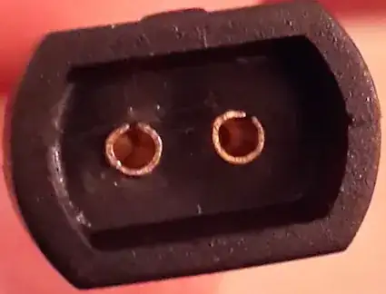

I have an AC to DC multiple output adapter. It has the following output:
Adapter output
I set the voltage to 5V. When I measure the supplied current, I get 3.26A.

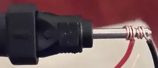

Then I connect an output to it:
Output
When I measure the supplied current now, I get 3.23A.

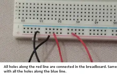

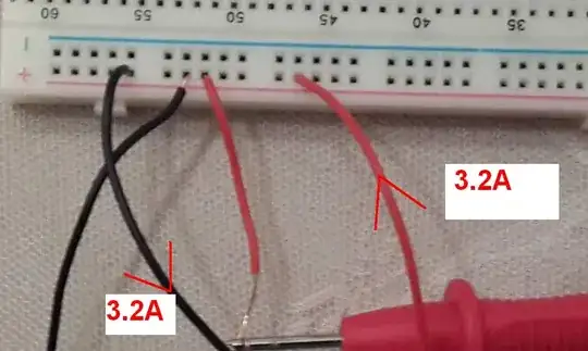

Then I try to measure the current on a breadboard:
Breadboard measurement
And I get 0.02A!
What is going on? Why is this happening?
More interestingly, I have discovered that the LED on my adapter gets dim proportional to the current it supplies. However, in all three measurements, although the results differ (especially the last result), the LED gets exactly the same amount dimmer. So this is a curious point as well.
Could you explain why the measurement on breadboard differs so much?

The 3.2A is now flowing through the short you have on your breadboard.
Try putting black wires on the blue line of breadboard pins.
Another bit of advice. Unless your power supply is current limited you might do it damage shorting it out like this.
In your breadboard setup you have put the ammeter/DMM in parallel with the source, which is shorted through the breadboard. In your first setup the ammeter was in series with the source, that's why it correctly measured its short-circuit current.
In general, 3A through a breadboard is not a good idea. And neither is shorting a supply that's not designed for it.

It looks like you have the + and - shorted out in the same track on the breadboard. The breadboard track will probably be getting hot. It is not a good idea to put an ammeter directly across the power supply like you have done in any of your examples anyway.
HandyHowie
  • 4,030
  • Yes but why does the result come up different? – Utku Dec 22 '15 at 21:20
  • Move the black wires to the track above and you should get the same results that you did in your previous tests. The way you have it wired at the moment, most of the current will be flowing through your short circuit and bypassing the ammeter. – HandyHowie Dec 22 '15 at 21:24
  • It comes out at basically zero at the breadboard because you have all the four wires plugged in there shorted together along one of the breadboard power rails. – Michael Karas Dec 22 '15 at 21:24
You have created a massive short circuit.
